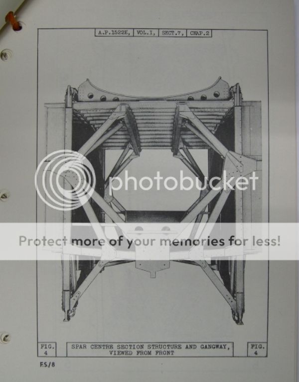

    Thank you very much for your comments Bill. The next pics are for you. Of course work on the centre section continues all the time. Occasionally, while waiting for new parts to arrive work stops, so other assemblies are tackled. This is what we are aiming for with the centre section:
    http://i639.photobucket.com/albums/uu115/elliott1940/137c0278-15fb-413f-9a11-b6d8b20111b3_zpscoy9qevs.jpg

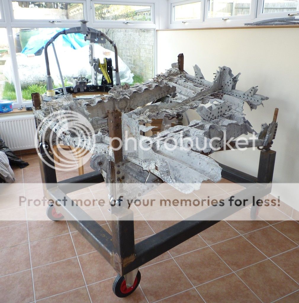

    Here is a reminder of what we started with – this is the burnt out, corroded centre section from Whitley N1498, the aircraft we are rebuilding. Some pics here with my friend Brian Dickinson at the site in 2001 http://www.scotcrash.homecall.co.uk/site20.htm.
    http://i639.photobucket.com/albums/uu115/elliott1940/P1000403_zpsb2rxkxpu.jpg

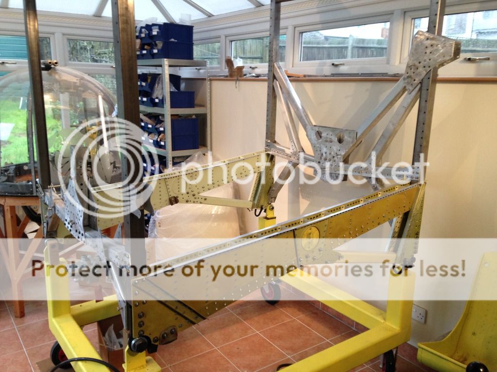

    Here it is today, on a very dark, wet and windy day, after a lot of hard cash and man hours and maybe even a few minor miracles… No expense has been spared to keep it is original as possible.
    http://i639.photobucket.com/albums/uu115/elliott1940/IMG_5540_zpsuzpi9vus.jpg
    Excellent progress update Elliott,
