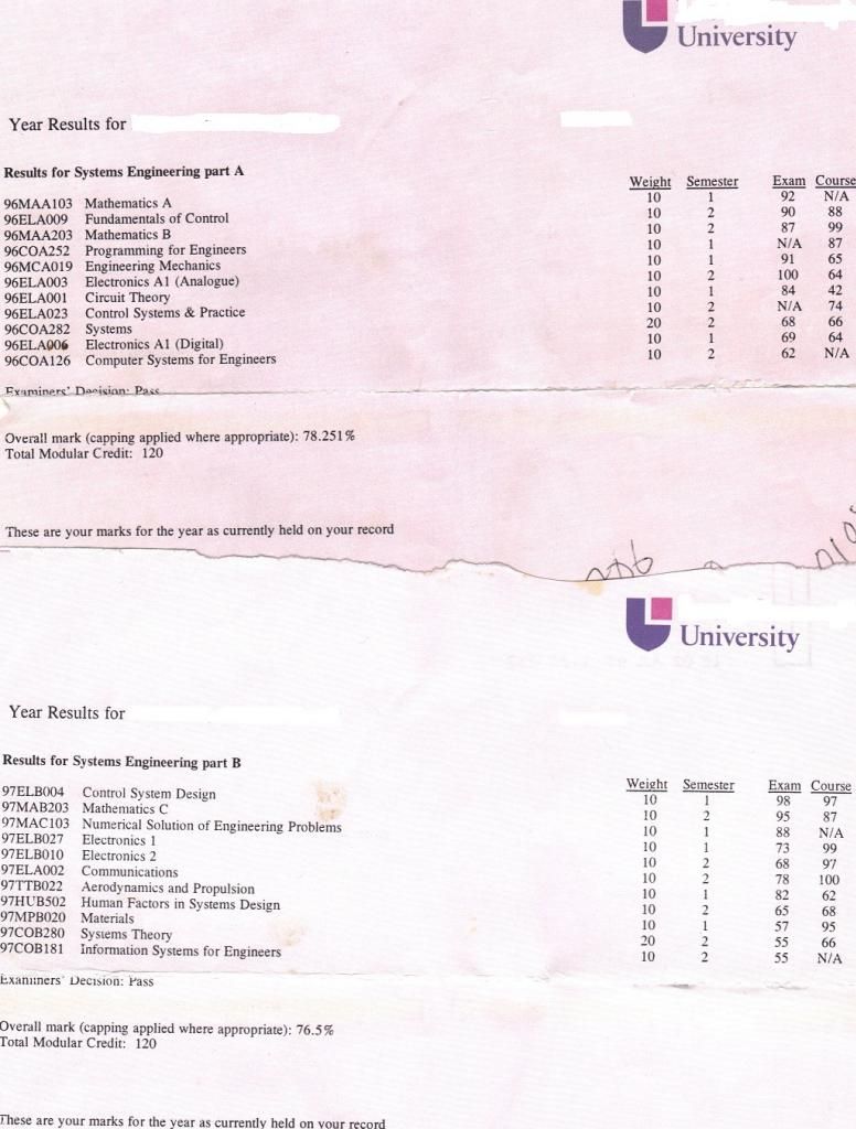

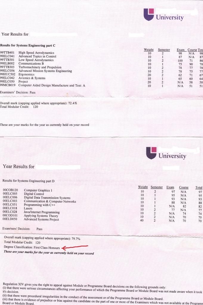

    He got a degree in engineering.. he must be so true.
    But… fench air force intelligence officers are not specifically engineers..and a vast part of pilots are not either.
    how about many other countries decide to abandon low flying tactic to go stealth route , they also have alot of scientists , engineers
    So, congrats to lukos but I’m affraid this sole degree does not help you planing a combat mission.. nor it does not prevent you to be biased. But don’t worry you’rz not the first one 😉
    agree , but not having a degree also doesnt prevent you from being biased does it , at least having a degree provide him with some knowledge about the subject

    Me ? I have ZERO experience in air strike planning or such. And i’m not trying to convince anybody about anything, …
    Why ? YOU (and Mig-31bm) are the ones telling us what strike method is better than the other , and seems to know better than some air force staff ! So tell us ! Do you have experience in planning strike mission , or are you an aero engineer , or something in that field . Simple. yes or no.
    this belong to lukos :
    http://i74.photobucket.com/albums/i245/lukos_/27-01-20101952352_zps6bc5c698.jpg
    http://i74.photobucket.com/albums/i245/lukos_/27-01-2010195235_zpse33791fb.jpg
