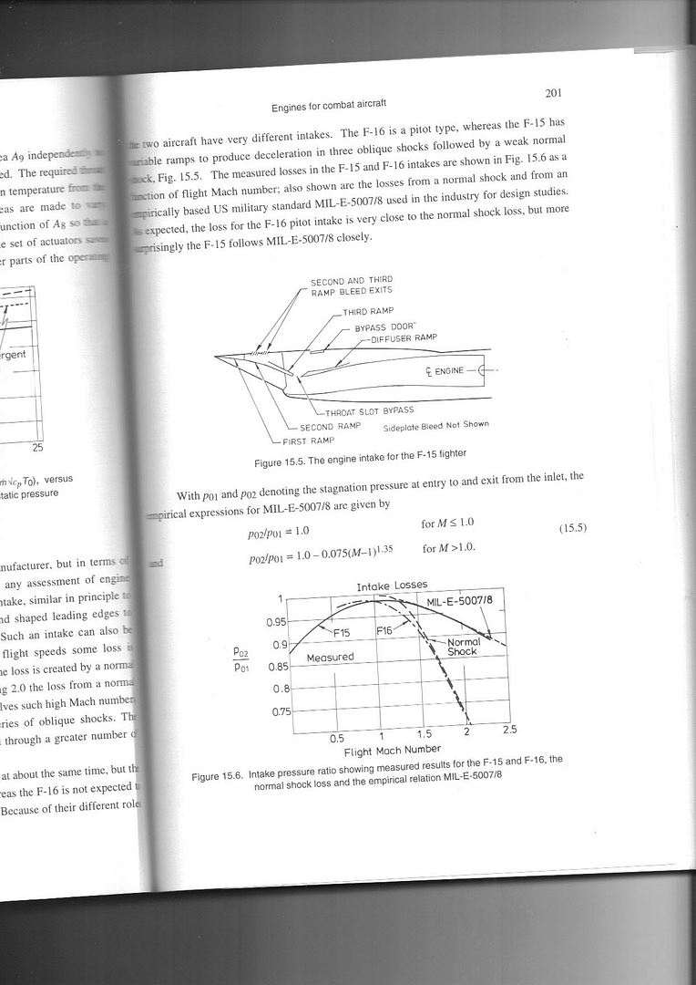

    The F-16 uses a pitot intake. If you don’t understand the difference between a fixed ramp and pitot I can’t help you. I suppose an inlet cone is also pitot by that reckoning?
    http://i1281.photobucket.com/albums/a508/sigmafour1/IntakesF15F16_zpsntfjkxp2.png
    One oblique shock and one normal is all you need a low supersonic speeds. If you have more than needed in terms of ramps for a given airspeed, it often reduces intake efficiency. See F-15 intake below M1.0 vs Pitot. There is no good reason for a fighter to have variable geometry given 99.9999% of its lifetime operating speeds. A Concorde has more need of variable geometry than a MiG-29 or Su-27.
