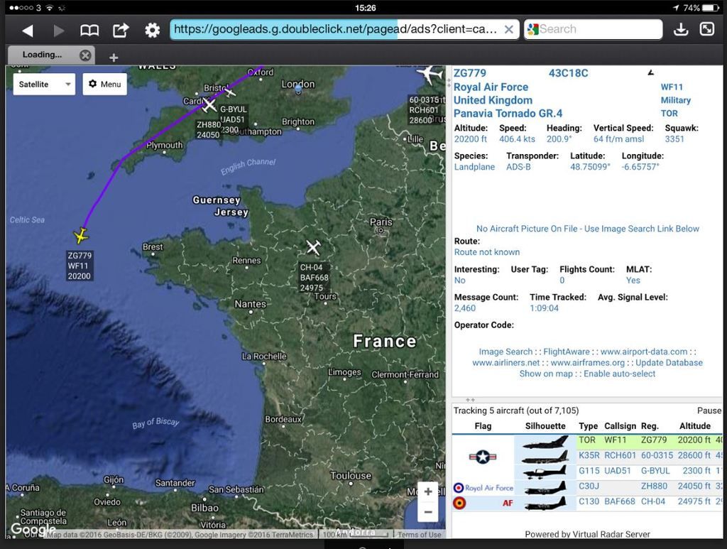

RAF Tornado GR4 out of RAF Marham likely with RAPTOR recce pod.

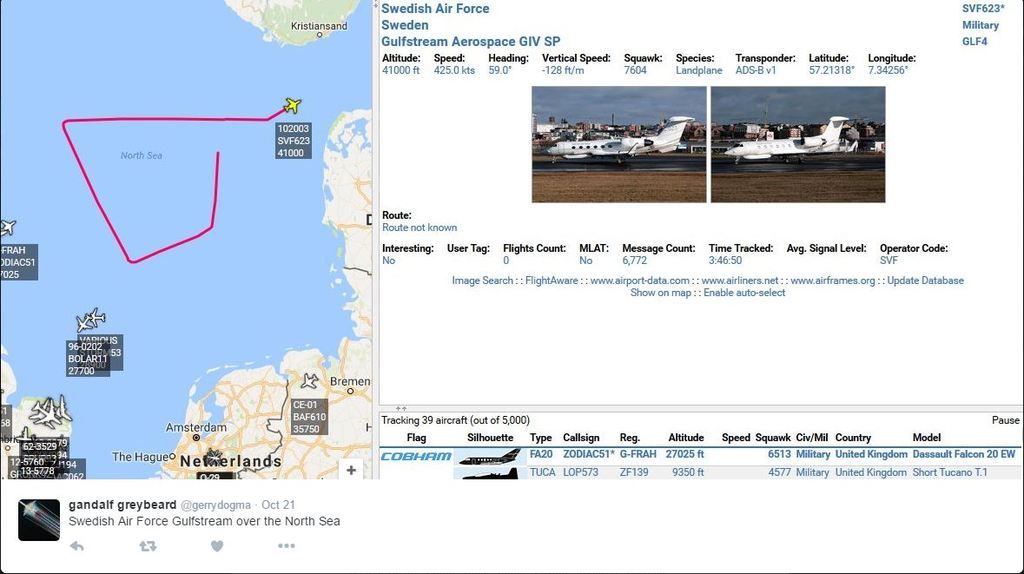

Swedish Air Force SIGINT/ELINT Gulfstream IV. Prior to the following mission they had conducted a mission further north off Norway.

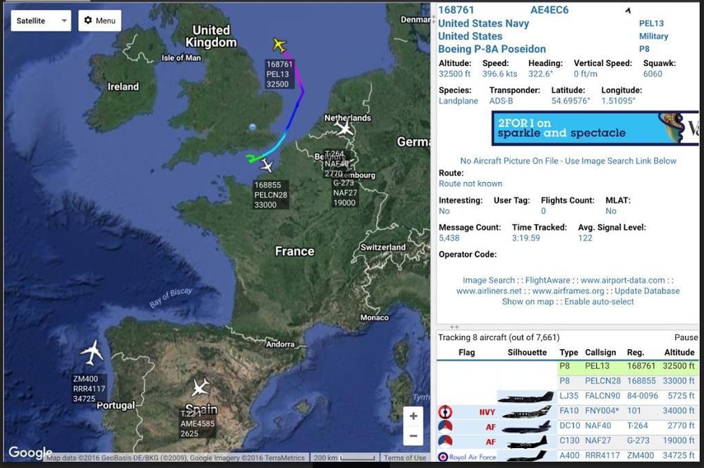

2 x US Navy P-8A Poseidon. At least one of them operating out of Keflavik,Iceland.

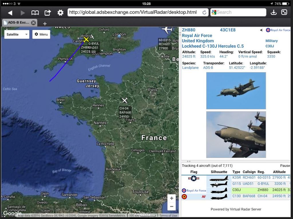

RAF C-130J operating out of RAF Brize Norton.

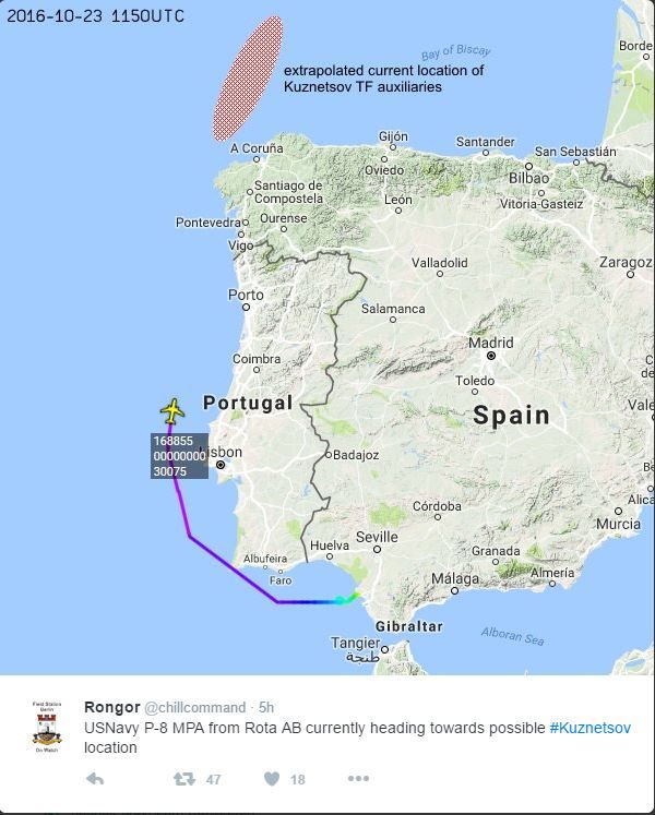

US Navy P-8A Poseidon operating out of Rota, Spain.
