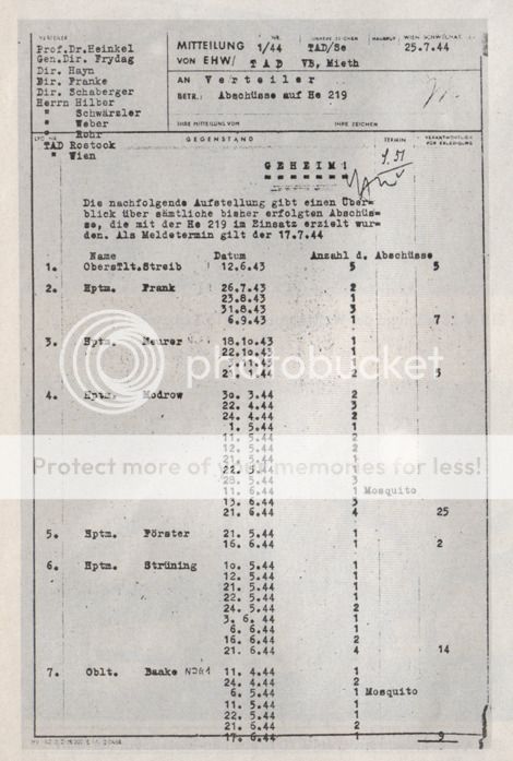

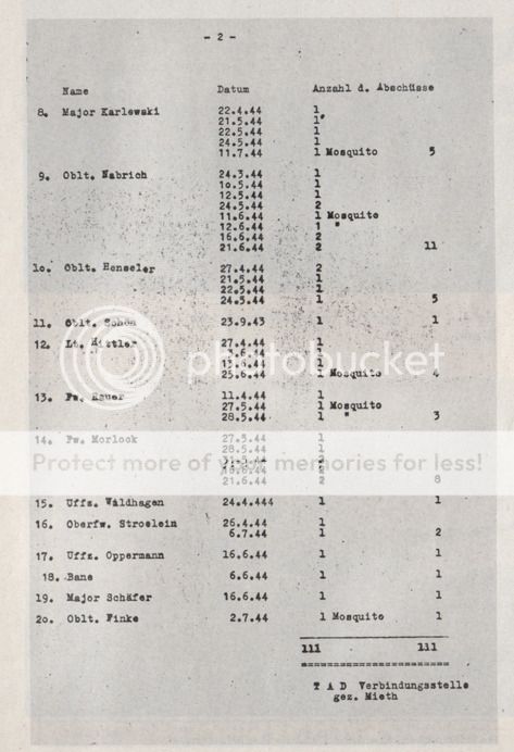

    Whether it was as good as that title and others have claimed is open to doubt … Mosquitos were such rare abschusses.
    Yes, bear in mind that it’s a list of claims: Finke’s can be shown to have escaped, and there’s no match for Rauer’s second, though a 139 Sqn aircraft was damaged by a fighter that night, I’ve not been able to cross-check time and place.
    Also bear in mind that the 219 had the same engines as the 410, on a larger, heavier airframe, fitted with flame dampers and festooned with aerials. The DB603A had to batter away on that bloody awful B4 fuel, so, “high performance” isn’t exactly a phrase which springs to mind.
    Mossies claimed more 219s than the other way round, though I’ve not been able to confirm them all, at least one is for a 219 with an under-slung jet, such creatures certainly existed, but none was reported lost in combat.
    in reply to: First Mosquito loss at night? #850643
    mhuxt
    “(The “six Mossies in 10 days in June ’43” is the biggest of the 219 myths, simply didn’t happen.)”
    Quite widely published myth. Any idea why?
    No idea at all. Possibly someone somewhere had some finger trouble, and an awezum story for a kewl aircraft sprang fully-formed into life.
    For the record, here’s Heinkel’s own list of 219 victories, up to 17 July ’44, put together as part of their plea to keep the 219 in production. This is from one of the German-language books on the aircraft, I’m no longer sure which one. If there are copyright issues, let me know and I’ll can the images.
    http://i937.photobucket.com/albums/ad212/mhuxt/219List_1_zpswczyaeyo.jpg
    http://i937.photobucket.com/albums/ad212/mhuxt/219List_2_zpsodhwn7y6.jpg
