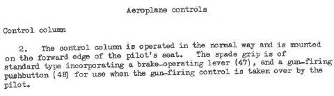

    the pilot still has to inadvertently press the firing button (is there a โ€˜safetyโ€™ around the button?) on his control column to fire the guns and Iโ€™d have thought that was pretty difficult to do without using your hands even if you were trying to do it (on a freely moving control column).
    ….THIS I can answer…
    http://i73.photobucket.com/albums/i234/phylo_roadking/defiantgunbutton.jpg
    It’s a damn’ gurt BIG button that would be hard to miss! ๐Ÿ˜ฎ Remember, it’s an elctrical switch, not a mechanical one – it might not have needed much pressure on it…

    Here’s the problem – the PILOT didn’t do this – the gunner did, with the master switch in the turret! I.E. the pilot couldn’t ever SEE what position that switch was in!!!!
    As far as the pilot was concerned, his firing button wasn’t “live”….until it was! Hell of a clumsy system…
    and kicked the control column, and have his arms outside the cockpit…
    According to Brew’s account this is EXACTLY what he did! ๐Ÿ˜ฎ He was cruising with the canopy pushed back and resting his elbows out on either side, on the cockpit sills!
    One oddity about the Defiant compared to other RAF fighters was that the control colum wasn’t mounted on the floor of the cockpit – it was on a pedestal that was part of the seat frame, sticking out between his feet! It’s possible this restricted further his ability to @rse about and wiggle around in the confined space.
