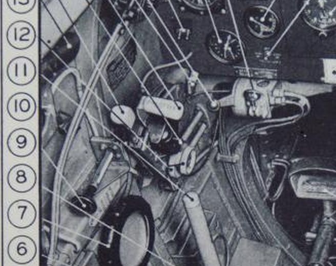

    Tony Hill
    Just remember Ross, the “Spitfire I” had the Ball lever, the rectangular one was Mk II.
    http://i24.photobucket.com/albums/c17/KillratioDH/PICT0033_zpsdlwt_zps2xak4zfd.jpg
    http://i24.photobucket.com/albums/c17/KillratioDH/B-Spit-19_zpsbfrt6ygj.jpg
