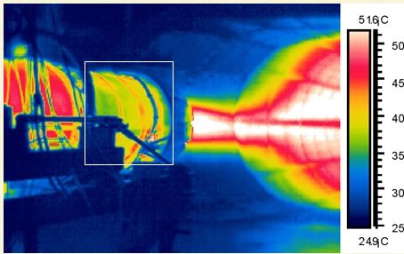

    mrmalaya :
    so that is fascinating. is that official about the cooling channel being designed in from the beginning reduce the IR profile of the aircraft?
    Of course ! You don ‘t design an engine this way just for the fun of it 🙂
    Where did those little piccies come from?
    The first one is from a Snecma pdf and the second one from the F-22 site .
    These sorts of things don’t make it invisible though do they? Just less obvious from distance to less sophisticated sensors?
    Still, good stuff. I assume this originated in the French strike requirement for the Rafale rather than to help it in A2A combat?

    mrmalaya :
    What do those articles tell us about the infrared emissions of the M88?
    The M88 uses a cooling system somehow similar than the F-22 engine with a cool-air bypass surrounding the combustion chamber to hide the IR emissions and cool the flame exhaust :
    http://i146.photobucket.com/albums/r279/sampaix/M88-4.jpg
    Similar than that :
    http://i41.tinypic.com/1zbxod0.gif
    Cheers .
