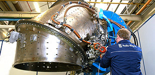

    Quite on the contrary, conceptually they are practically identical.. and rightfully so.. it would be outright lunacy for the P&W/RR not to use all that available experience from the Yak-141. Only morons would dwell on artificial supremacy and false pride..
    http://www.rolls-royce.com/~/media/Images/R/Rolls-Royce/content-images/landing-page/customers/defence-aerospace/lan-310-x-150-002-tcm92-58856.jpghttp://www.leteckemotory.cz/motory/r-79/r79v_01.jpg
    True, tell paralay that his claim is hubris. Not only was the 3bs nozzle not patented on the yak-141, but the X-35 already had said nozzle design before before L-M or Pratt ever got to inspect the Yak-141. The rest is internet pseudo-history.
    No doubt US designers were curious about the Russian swivel design to see if there were any improvements that could be implemented.
    FBW
    The nozzle F135 – a copy of the nozzle engine R-79
    Um no, only internet morons actually believe that. Thankfully we have the ACTUAL PATENTS to prove that is B.S.
