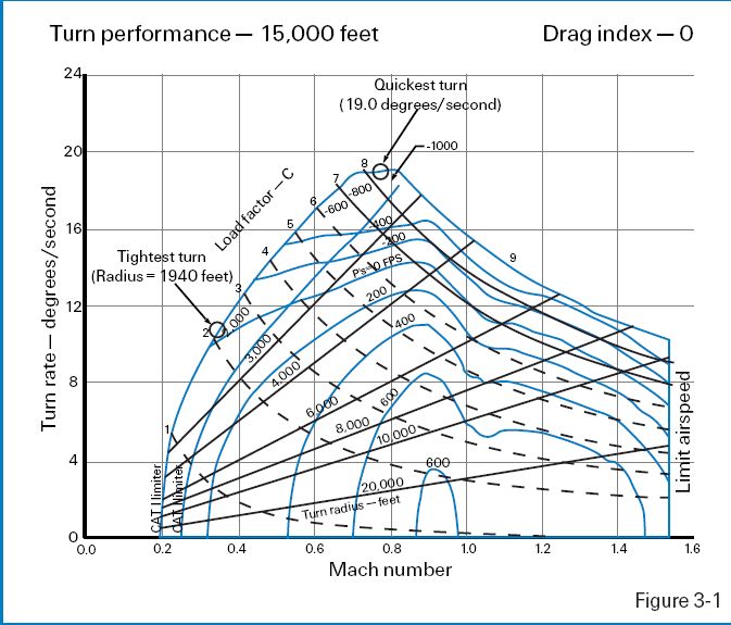

    But you have no idea that sustained turn rate and angle of attack are not related. A plane with a low angle of attack can still maintain a high sustained turn rate by navigating through an outer wider circle faster. What does AoA has to do with sustained turn rate?
    AoA is seperate from sustained turn rates. In fact, with every wing, once the AoA reaches 25 degrees, you begin to get more drag from lift, and the ratio of drag rises as lift lessens as you increase AoA. To have optimal turn rate, plane has to be around 20 to 25 degs AoA.
    Angle of Attack is connected to the STR as well as the L/D and Ps, it is one of the most important flight parameters because L/D depends on Cl and that depends on the AOA, which at the end mean pulled G`s. Of course you have to get the optimum among all those parameters such as lift/drag/AOA and Ps/altitude/engine settings, but the same deals for the speed. Explain why the STR increases and then decreases with speed, see graphs below.
    http://www.gamaholding.sk/test/turnratef-16.jpg
    http://www.gamaholding.sk/test/f16sust.jpg

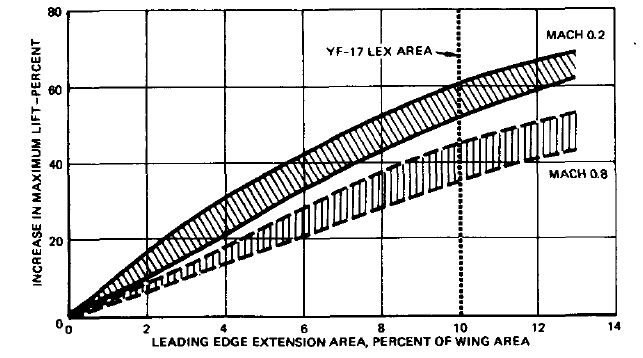

    LD ratios has nothing to do with compound sweep. The lifting area of LERX is too small to offer significant lift, when compared to canards. LERX plus main wing do not make a compound sweep wing..
    You are going to be surprised, but the LERX/WING on the Mig-29, Su-27,F-18 works the same way as double deltas, where the vortex system created on LERXs decrease wing`s actual AOA and produce a non-linear gain of the lift. Call it whatever you want a compound, hybrid, double delta, LERX plus WING…etc The same way behave canards, but with more effectiveness at critical AOA because they are better adjusted to main wing AOA.
    Look at the graph below, it shows the effect of leading edge extension size on maximum lift.
    http://www.gamaholding.sk/test/figure.jpg
