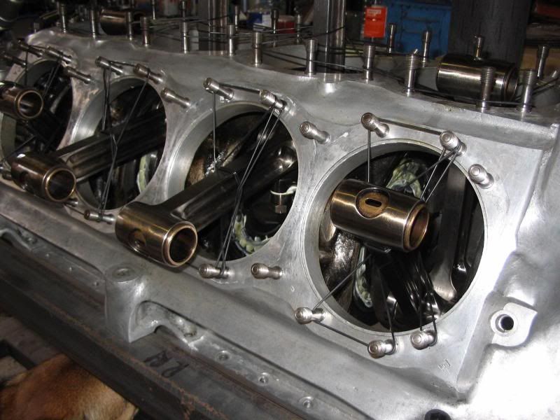

    Hi to all interested in old aero engines, I have made further progress to the Lion engine recently, the cylinder block assembly’s are also complete and the engine carrier has been started.
    http://i70.photobucket.com/albums/i101/racer2_uk/NapierLion51383conrodrefit8.jpg
    http://i70.photobucket.com/albums/i101/racer2_uk/NapierLion51383conrodrefit2.jpg
    Andy

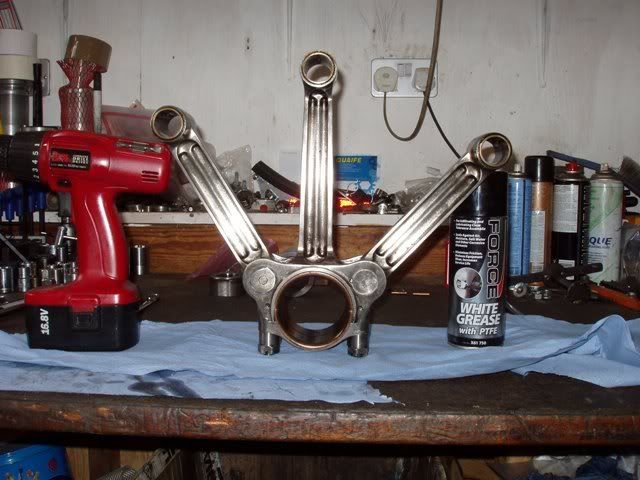

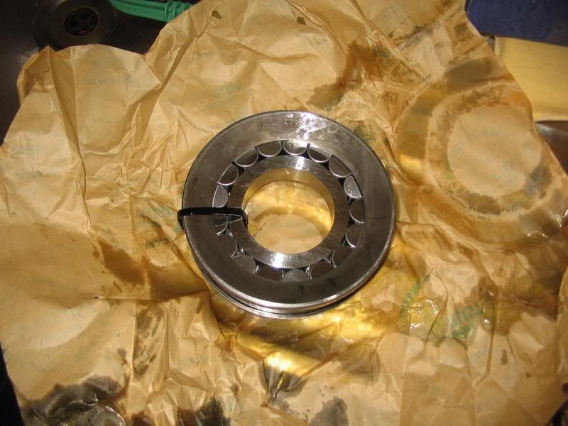

    The Lion has 5 roller bearing’s and a plain bearing on the crank, the rear bearing in the photo and the front are smaller than the middle three.
    The rod’s when first removed,
    http://i70.photobucket.com/albums/i101/racer2_uk/NapierLion51383rearrods.jpg
    and after a clean,
    http://i70.photobucket.com/albums/i101/racer2_uk/NapierLion51383conrod.jpg
    Andy

    Close enough, Napier Lion rear crankshaft bearing, reconditioned ready for rebuilding.
    Andy

    The bearing is a recon unit.

    http://i70.photobucket.com/albums/i101/racer2_uk/reconbearing.jpg

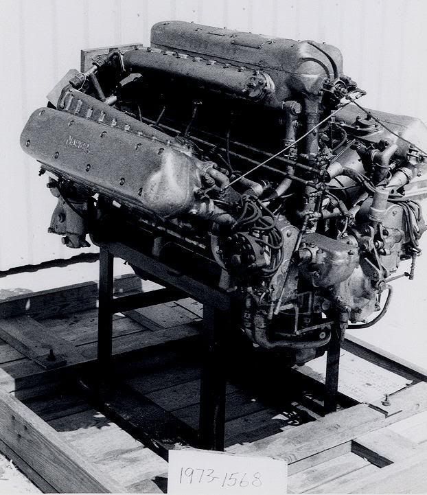

    Hi Roger and all,
    Both engines have decompressor linkage fitted which indicates they are early, probably series II or IIB, the older of the 2 has a gas starter system, the more recent a fuel primer and a hand crank.
    I haven’t got the expertise to comment on why the engine numbers are so far apart for a pair of aircraft built together.
    23812
    http://i70.photobucket.com/albums/i101/racer2_uk/NapierLion23812Smithsonian3.jpg
    24541
    http://i70.photobucket.com/albums/i101/racer2_uk/NapierLion24541Smithsonian3.jpg
    The Smithsonian museum were very helpful with information and photo’s.
    Andy
    in reply to: Napier Lion Engines – Survivors #1224410
    racer2_uk
    Hi roger and all,
    I have found further information regarding the 2 Lion engines with the Smithsonian museum, they are from a pair of Blackburn Swift “F” aircraft No.s A6056 and A6057, built in 1923 and on test at the US Navy base at Anacostia.
    A6056 had a minor accident in October 1924 and spent 2 hours in the sea before recovery, this aircraft was then used as spares for A6057.
    All the information has come from the Smithsonian and the excellent “Blackburn Aircraft since 1909” by AJ Jackson.
    Andy
