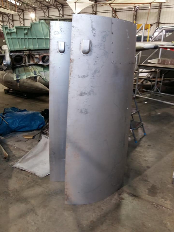

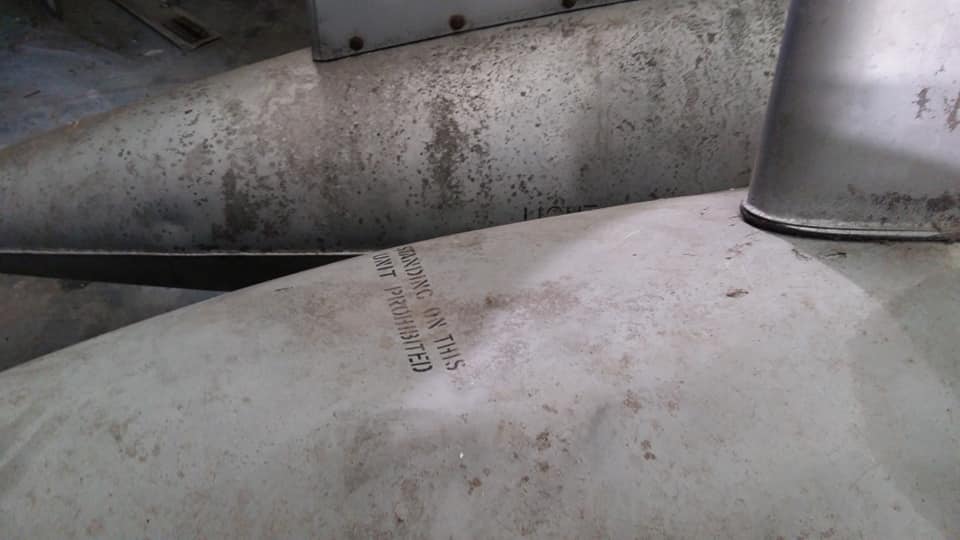

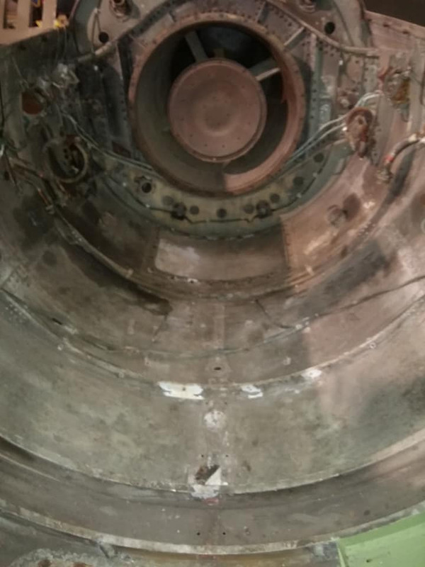

    I spent a chunk of the morning finishing the rub down of the inside of the starboard inner undercarriage door, and while I was at it one of the port nose panels which had been overlooked. I then replaced some blown rivets in the door, before treating both items to an etch prime
    https://i.postimg.cc/3NS3xnky/71300987-2428217570783604-1425904209986846720-o.jpg

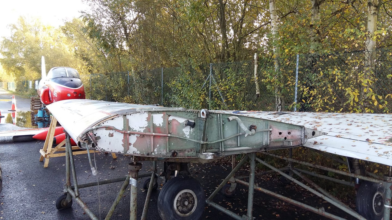

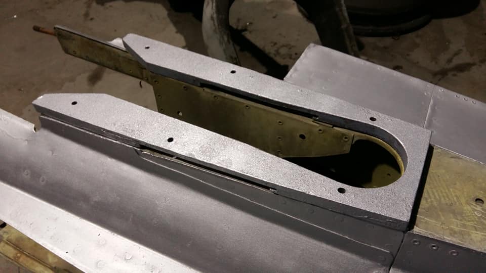

    So I then continued the afternoon throwing silver paint at various bits of the jet…
    https://i.postimg.cc/QtqXRXsJ/73249208-2428406174098077-4766972644073406464-n.jpg
    https://i.postimg.cc/CKkMsGQt/72924396-2428406224098072-7724338896187686912-n.jpg
    https://i.postimg.cc/3xPJGSnm/72911824-2428411644097530-5577653059837755392-n.jpg
    https://i.postimg.cc/yY8dCSDg/73399781-2428411710764190-867236884420493312-n.jpg
    https://i.postimg.cc/Njyj5q7Q/75650490-2428406287431399-8504792620612976640-n.jpg

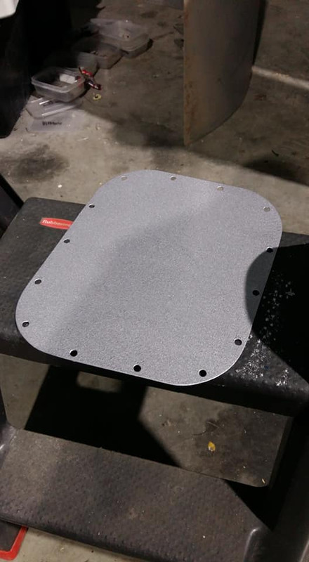

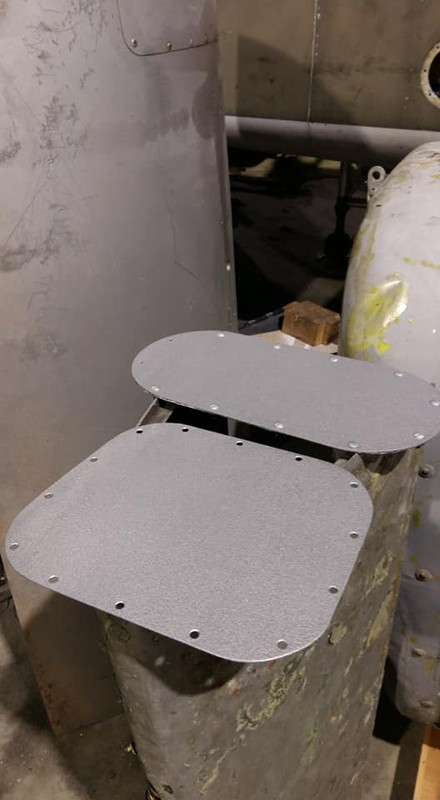

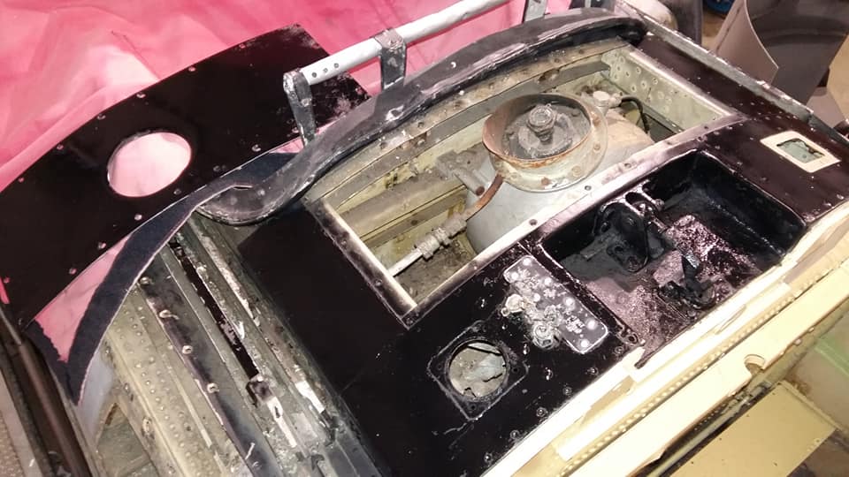

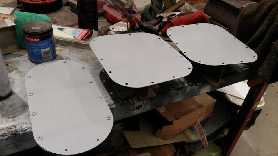

    Then, some panels got a bit of paint added. Primer for the underwing access panels and NOS fuselage access hatch
    https://i.postimg.cc/qq49k0Hq/72667839-2422891377982890-4550580801447657472-n.jpg

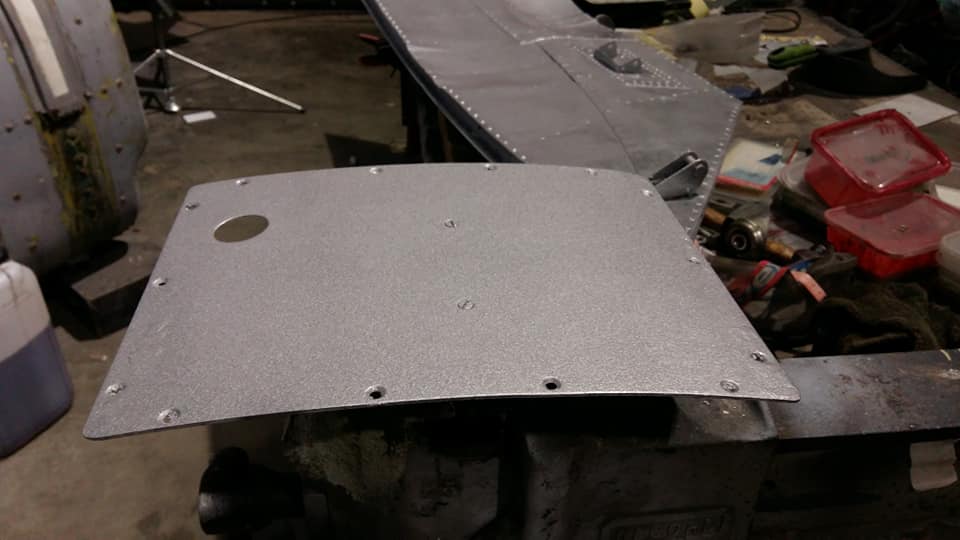

    More primer for the outer skin of the inner u/c door
    https://i.postimg.cc/JnbfV0gS/73324067-2422963424642352-1193471712482557952-n.jpg
    And a couple of coats of black for the cockpit rear decking and the hyd tank access hatch
    https://i.postimg.cc/pX0gtgGV/75398288-2422963294642365-1496317531630075904-n.jpg
    https://i.postimg.cc/Gh3ZVcjS/73446264-2422963367975691-4036940959529828352-n.jpg

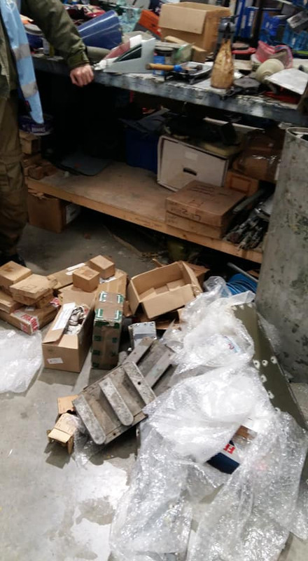

    As regular readers know, we are a resourceful lot. If we see something discarded which we can use, we aren’t too proud to claim (or as we say yoink) it! Last week I yoinked a whiteboard out of the skip. It has now been set up and re-purposed as a status board for the jet, so we can keep an active record of when maintenance has been carried out on 788 and her support equipment. You’ll see all the important stuff is recorded!
    https://i.postimg.cc/wvq3yZYb/72542208-2413255702279791-3831527031837818880-o.jpg

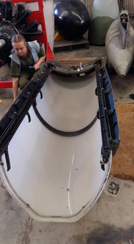

    On Thursday, we had a group of visitors from East Midlands Aeropark. You may remember they donated us a new pair of lower nacelle assemblies for 788? Well on Thursday we got to repay their kindness. They have an NF.14, WS760, in need of a lot of love. As well as some old handling damage, they have to contend with the fact that theirs is missing a number of vital parts due to theft which occurred a few years ago. I spent most of the morning with them as they photographed and inspected WS788, particularly the bits they will either have to make up from scratch or restore. One very good thing to come out of this is the likelihood of them solving our canopy woes, by borrowing our front section to use as a template we can help them and they in turn will help us. With this in mind I pointed Eloise at our canopy and set her on continuing the extraction of the many unwilling screws still holding the perspex sections captive!
    https://i.postimg.cc/0jrQZSQY/74275645-2413151802290181-1394681120594853888-n.jpg

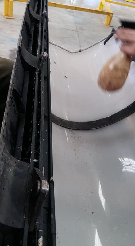

    After our visitors had gone for a look around the rest of the museum, I also got in on the canopy dismantling game
    https://i.postimg.cc/j5M2zcsq/72834200-2413151842290177-5699551004861661184-n.jpg
    While progress was made, there’s still a lot more to do. I see drilling of screw heads in our future…! Once we were both thoroughly fed up with that game, our attention turned to the underwing tanks which were donated to us by NELSAM last year. More specifically, the huge dents in the top of them where someone has clearly ignored the instruction to not stand and, well, stood… I decided a while ago to try and blow the dents out so, after making a suitable blank for the fuel discharge pipe, my trusty compressor was fired up and, slowly and carefully, we blew the worst of the dents out of the tanks!

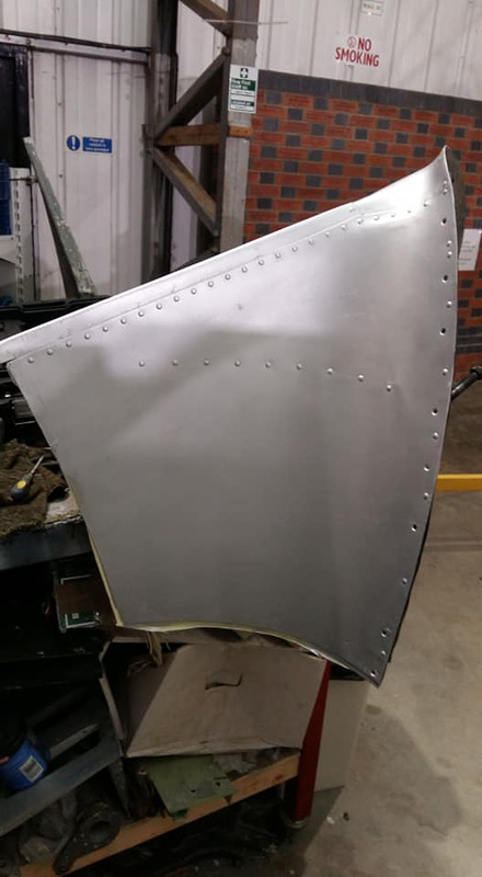

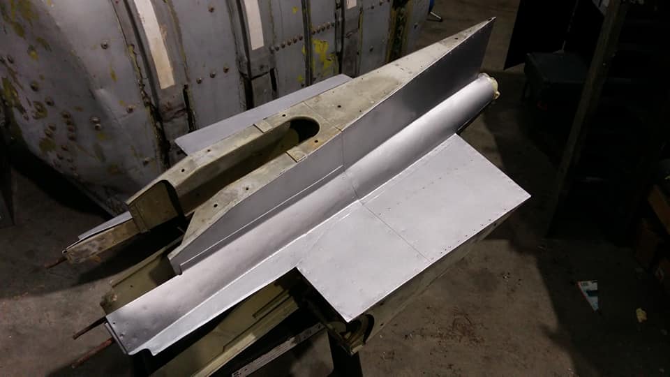

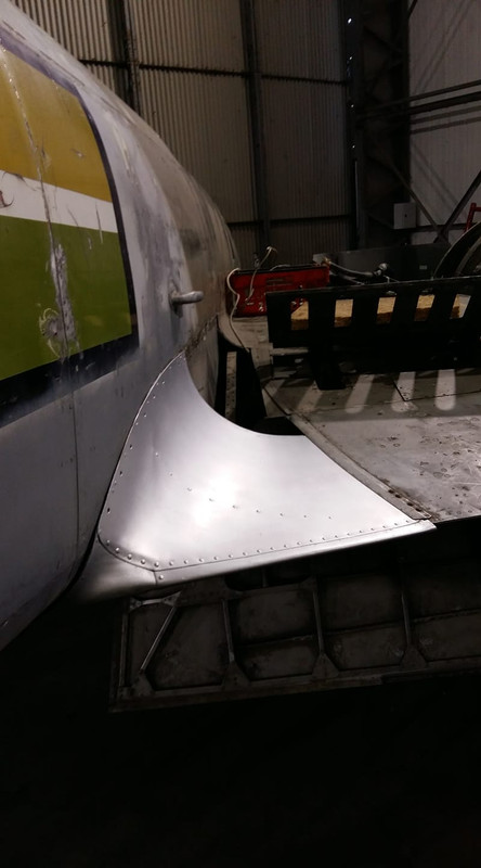

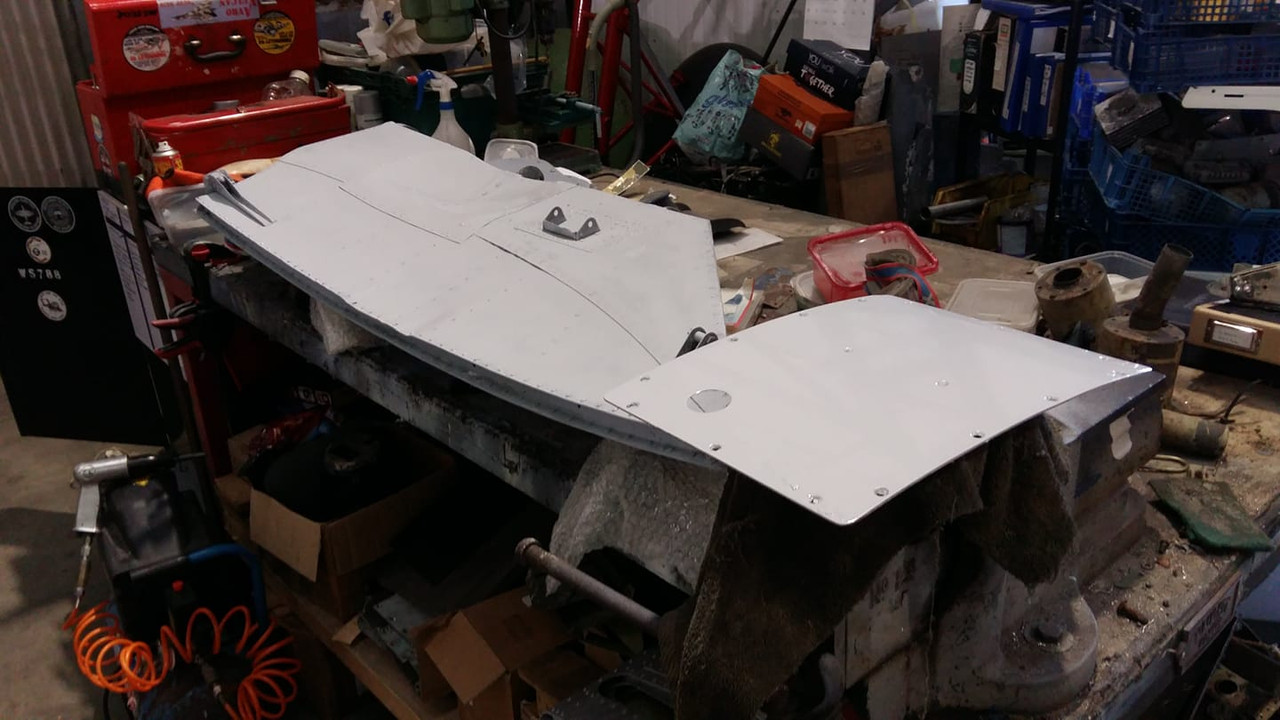

    I then rubbed it, and while I was at it our cruciform fairing, back ready for a silver topcoat
    https://i.postimg.cc/jdLw4pwp/73498090-2415121798759848-9073432323369730048-n.jpg
    https://i.postimg.cc/sfnGSjXP/72481684-2415121715426523-3680610947732340736-n.jpg

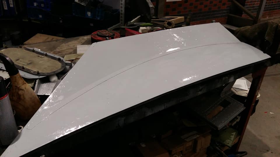

    After going for a hot chocolate to give them chance to cure, I came back and decided the best place for now to keep the wing fillet safe was on the jet…
    https://i.postimg.cc/dtYWp9vt/72527978-2415323772072984-2570994035002966016-o.jpg
    Not a bad result for 20 quid and a bit of Elbow Grease!

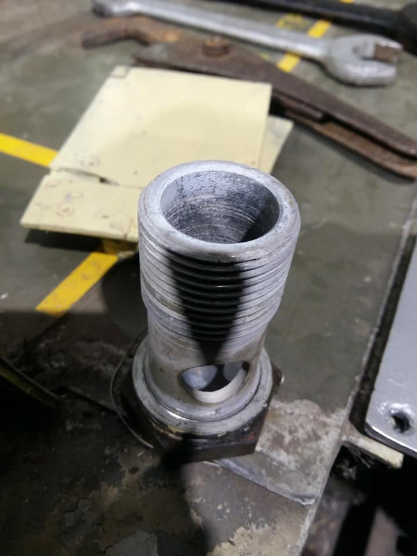

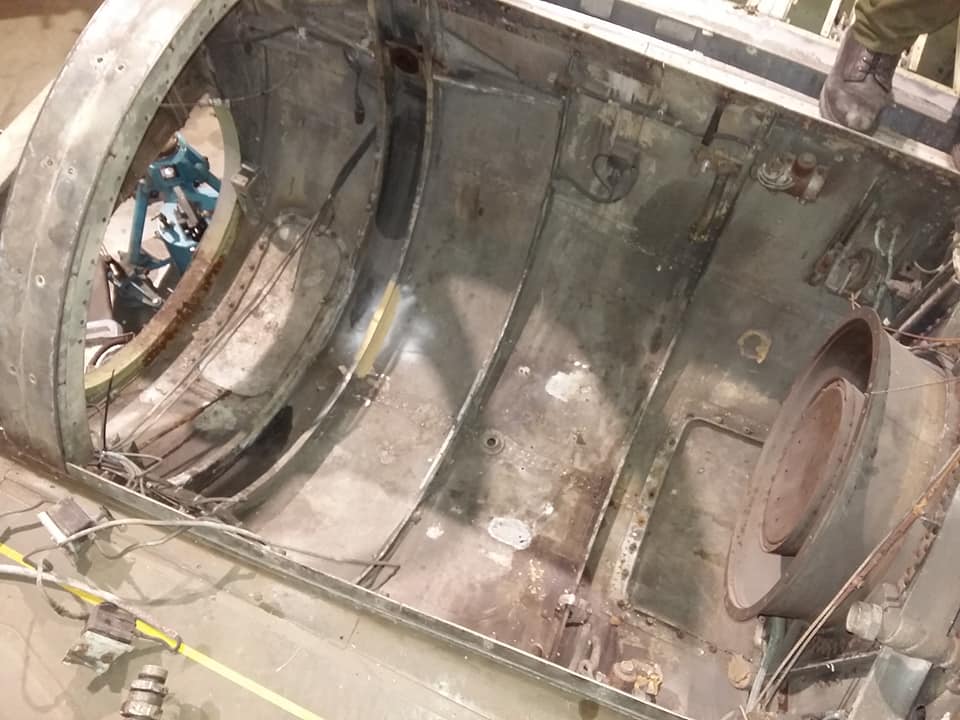

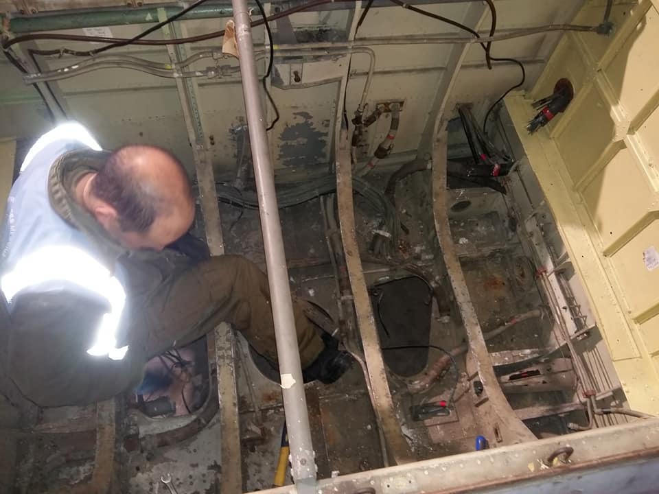

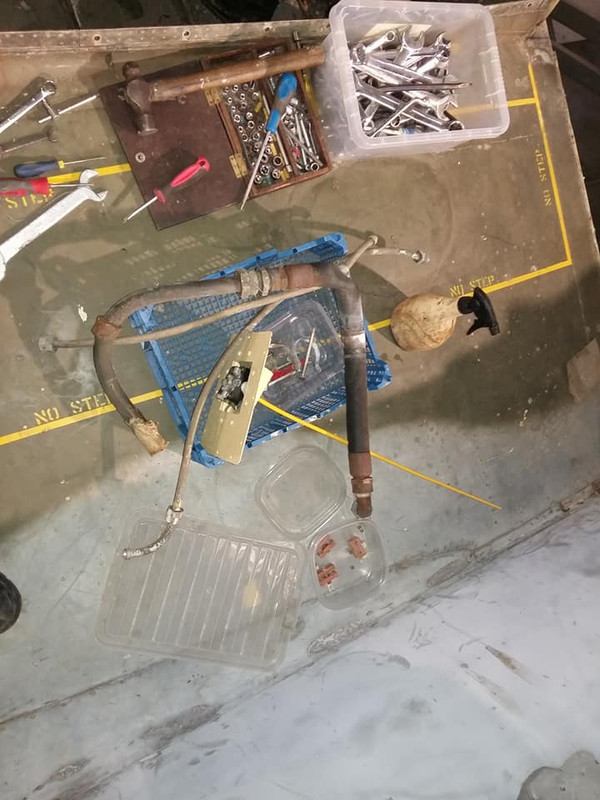

    After lunch, having raided Engineering for a suitably large spanner, we removed the fuel lines which run through the bottom of the engine bays from the drop tanks, and the fuel feed lines to the engines. This banjo off the starboard engine fuel feed won’t have been off since 1965, yet it’s immaculate!
    https://i.postimg.cc/Vs3mn5k9/72425825-2409525209319507-2274534978253488128-n.jpg

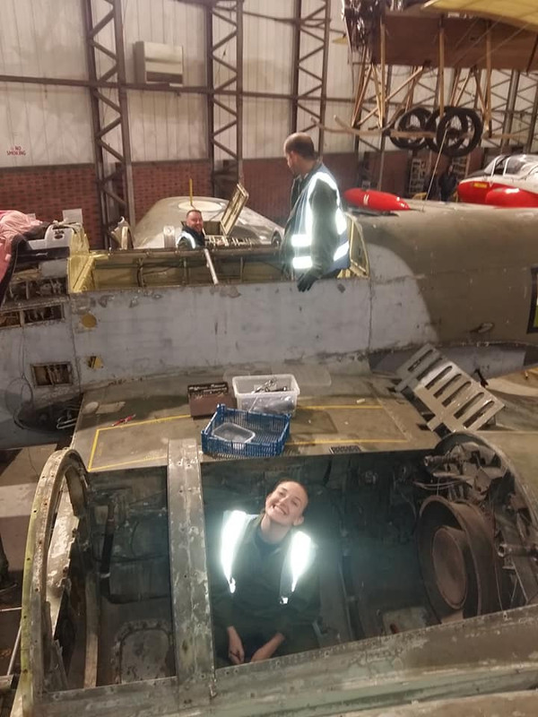

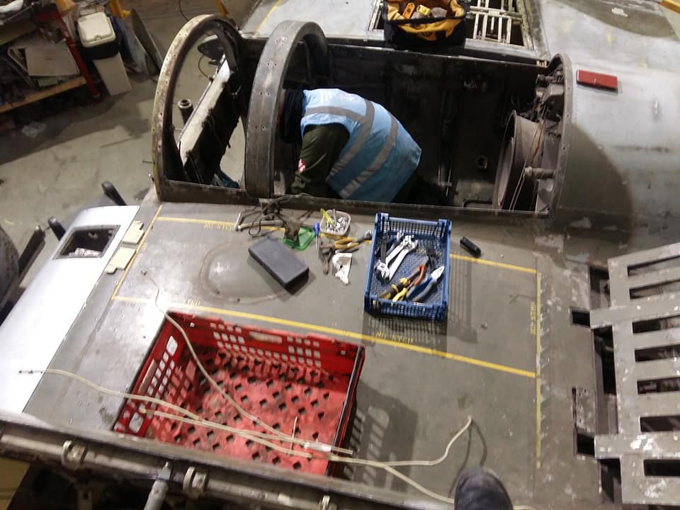

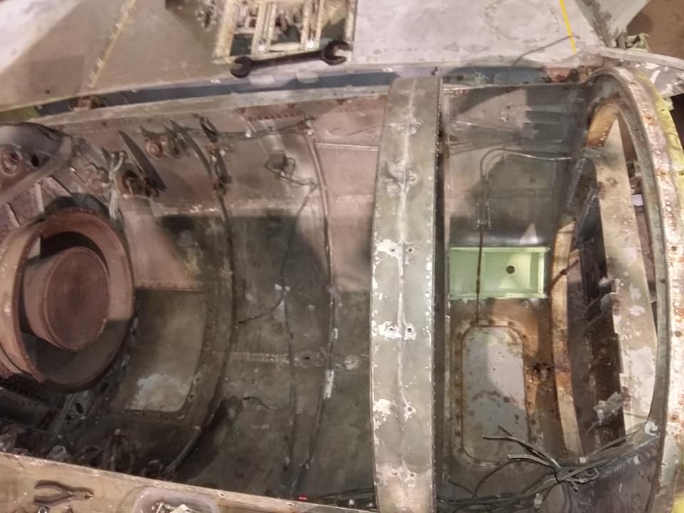

    Close of play saw both engine bays de-cluttered up to the rivet line, and wiring etc secured out of the way as much as possible. You can see in some of these shots the corrosion which makes replacing the nacelles with brand new items a very attractive option.
    https://i.postimg.cc/KcKm1txv/72712784-2409525695986125-7364416066937683968-n.jpg
    https://i.postimg.cc/T3xxNSmp/72047954-2409525752652786-1066030167270359040-n.jpg
    https://i.postimg.cc/BtWY6rsD/72124359-2409525975986097-1025213753026674688-n.jpg

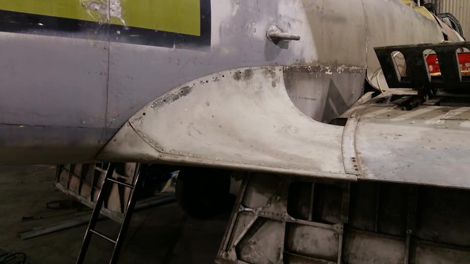

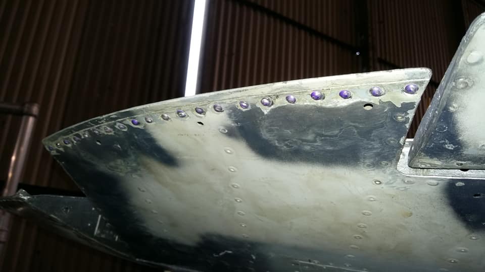

    13/10/2019 Update… AKA the “What I plundered from Newark Aerojumble” edition…
    …which wasn’t that much really! It was good to catch up with a number of people, (Paul Relight9, I did spot you at a distance briefly!) and that a good number of people saw the crew t-shirt and figured out who I am and asked how the project is proceeding, as a result of being made aware of it by my posts on here, so thank you all for taking the time to chat and show your interest!
    The main aim of the day was to pick up the new lower nacelles we tried to gather last aerojumble, but Scott’s van was too short. So this time my boss very kindly let me borrow the transit from work, which proved ideal! These nacelles were very kindly passed my way by the wonderful chaps from East Midlands Aeropark; Huge thanks guys! Here they are safely delivered to Elvington, to meet the aircraft they will finally be attached to probably 60 or so years after manufacture!
    https://i.postimg.cc/RhmyVGys/72687648-2408787406059954-3535137536378667008-n.jpg
    I also acquired a starboard rear wing root fairing, in much better condition than 788’s. Here it is with the nacelles
    https://i.postimg.cc/C1k9g9Pn/71674478-2408787439393284-8602042306670886912-n.jpg
