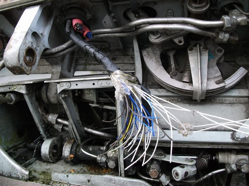

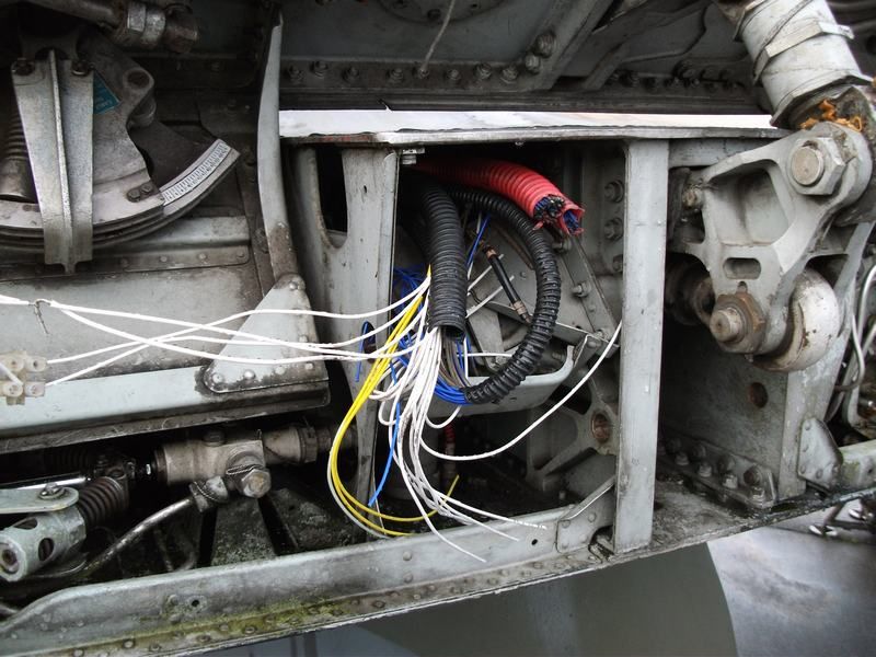

The port wing wiring was also completed along with the port aileron cables.
All being well 544 will be run on both engines simultaneously in a few weeks time!
The wires all look the same, how do you know which is which without trial and error?
It’s a pain staking job of metering them all out! The electrical manuals are a must for this sort of thing as it cannot be done without them. Fortunately the colour coding helps a little. E.g. the wires in the photos are coded as follows:
Blue = Autopilot (for the ailerons).
Yellow = Micro-switches (for the autopilot over travel disconnects).
Whites = Wing tip Formation and trailing lights etc.
Screened = Antennas etc.
All of the cables in the red coloured flexible conduit are armament cables for the pylons. These are no longer need and were simply removed.

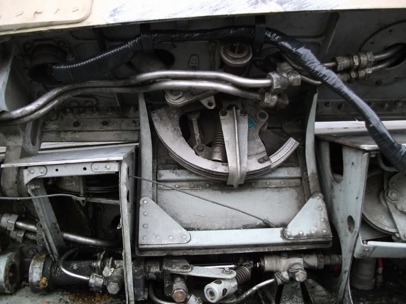

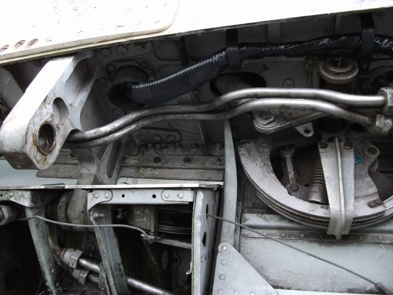

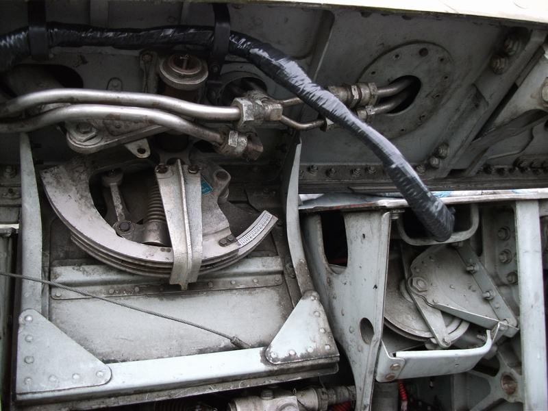

Buccaneer XW544’s starboard wing wiring was finally sorted out yesterday!
Before…
After…
The port wing will get the same treatment in shortly!
