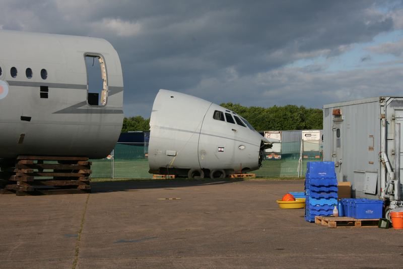

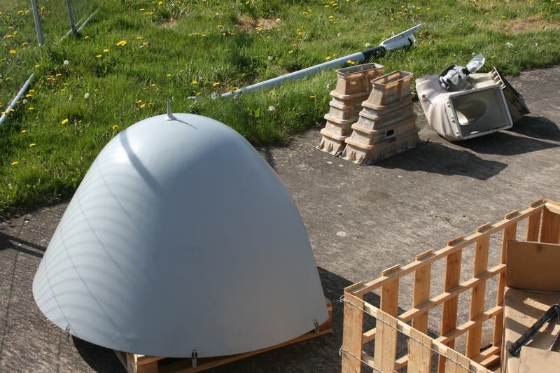

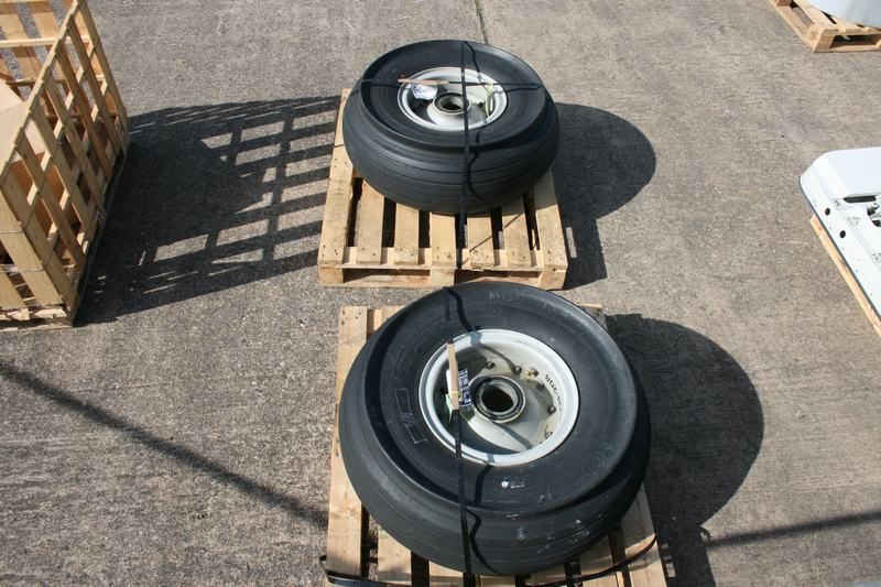

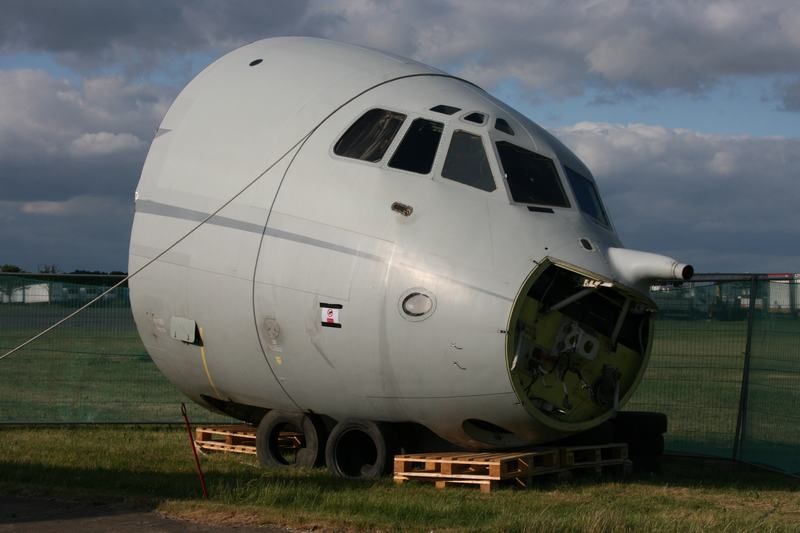

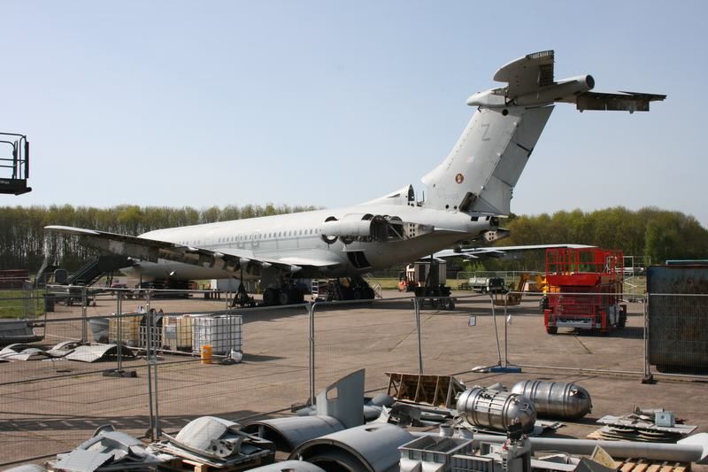

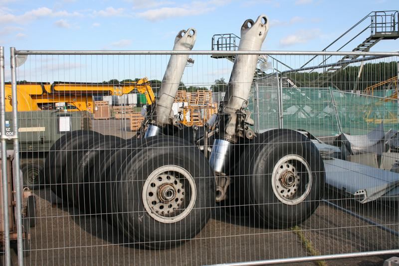

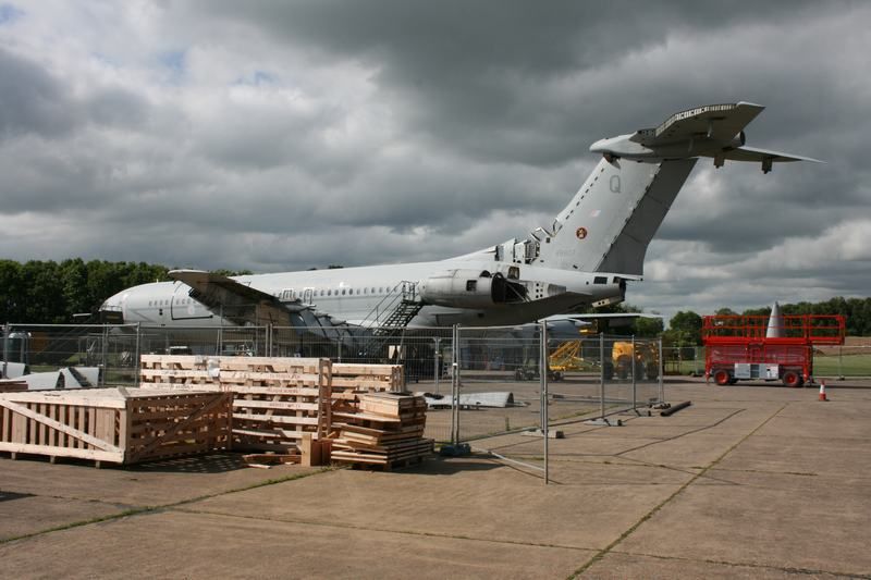

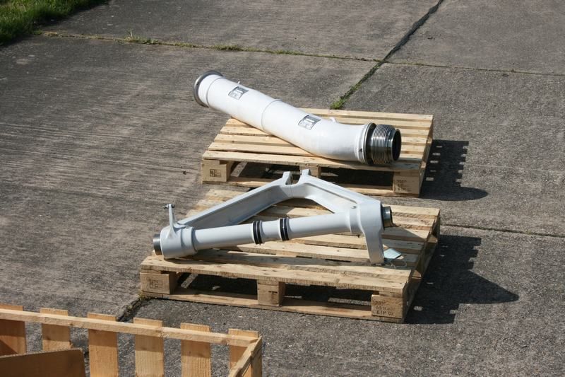

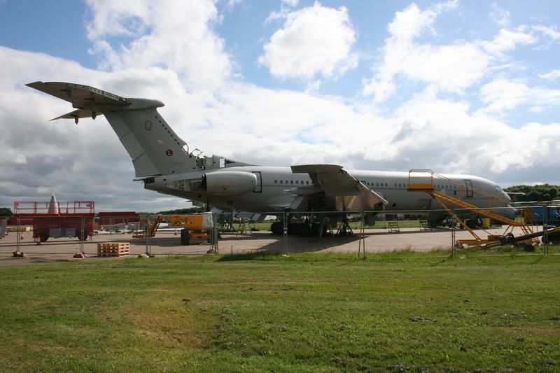

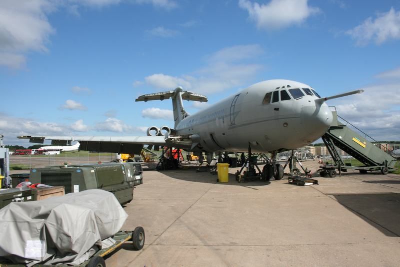

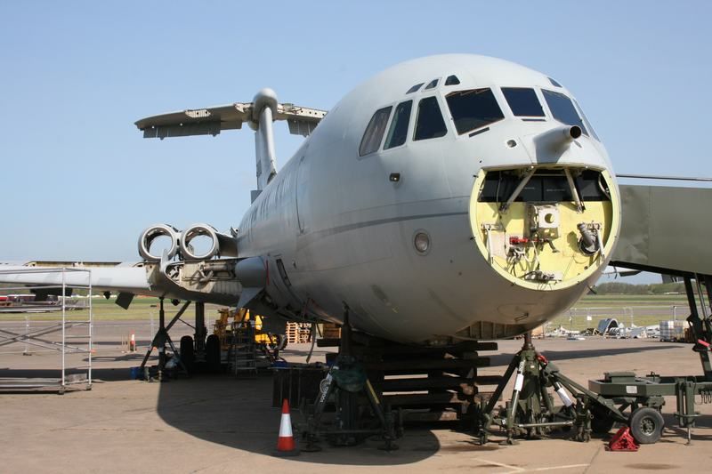

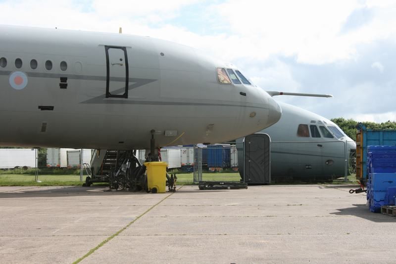

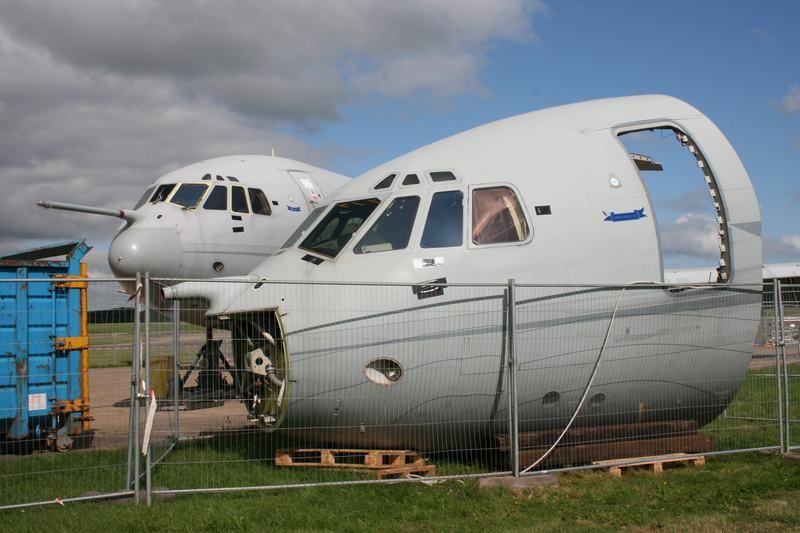

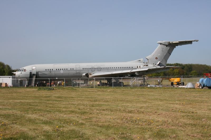

    It’s now XR807’s turn to go through the reclamation process. XV109’s remains were shredded whilst I was away on holiday so no gruesome final photos I’m afraid!!

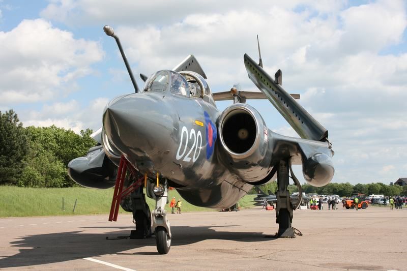

    Here is a couple taken by our Buccaneer back seater on the open day…

    It was definitely a good event this year and our own Buccaneer XX894 also preformed very well 🙂

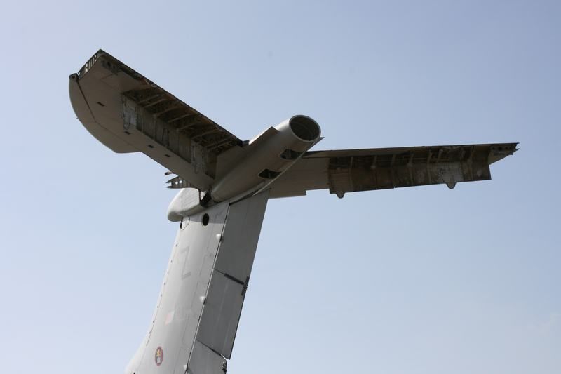

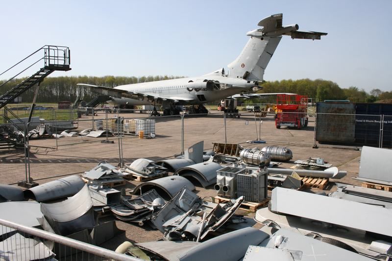

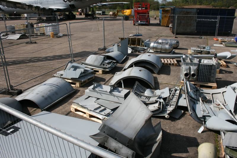

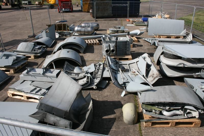

    One more week to go before the remains of XV109 goes through the shredder 😮
    Looking at her now it’s hard to believe I watched her fly in only seven weeks ago 😡

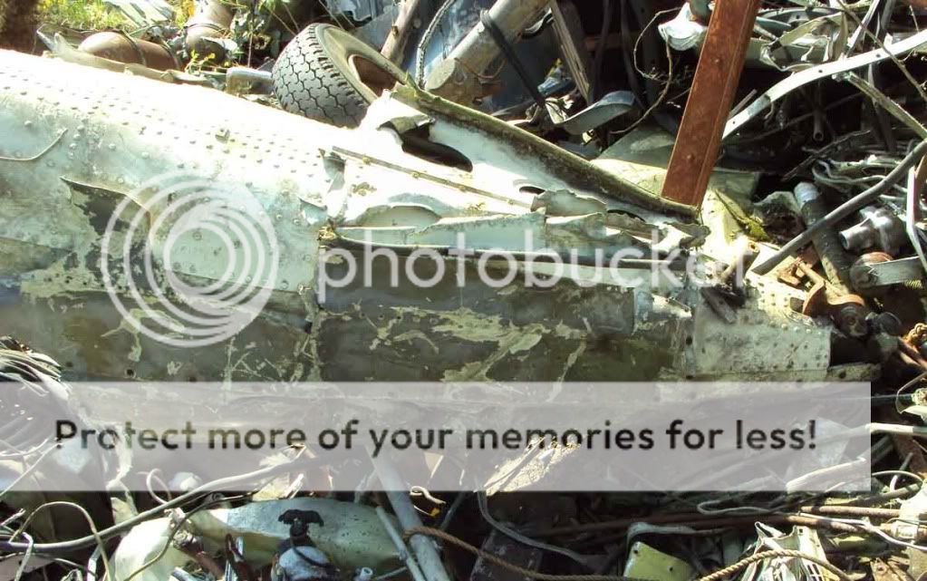

    http://i890.photobucket.com/albums/ac109/Stuart_H/published/tail.jpg?t=1274525989
    Tail cone – Ballioll? SCimitar? – See Als earlier photo for a different view.
    Definitely 100% a Buccaneer slipper fuel tank…:D

    This is how it all looked on Saturday 15th May…

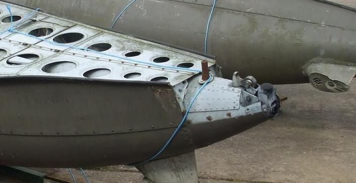

    Buccaneer XX894 Latest
    With little hope of finding the nose cone for the port slipper tank the decision was made to just fabricate the whole thing with resin.
    First a cone shape was mould was made which was taped on the front of the damaged tank…
    http://i44.photobucket.com/albums/f39/plazzdaman/Slipper%20Tanks/0066.jpg
    http://i44.photobucket.com/albums/f39/plazzdaman/Slipper%20Tanks/0068.jpg
    Resin was injected into the mould, allowed to set which in turn produced the following results…
    http://i44.photobucket.com/albums/f39/plazzdaman/Slipper%20Tanks/0071.jpg
    http://i44.photobucket.com/albums/f39/plazzdaman/Slipper%20Tanks/0072.jpg
    Some grinding, filling and sanding is starting to produce the desired result…
    http://i44.photobucket.com/albums/f39/plazzdaman/Slipper%20Tanks/0093.jpg
    http://i44.photobucket.com/albums/f39/plazzdaman/Slipper%20Tanks/0094.jpg
    The other dents were also filled…
    http://i44.photobucket.com/albums/f39/plazzdaman/Slipper%20Tanks/0092.jpg
    http://i44.photobucket.com/albums/f39/plazzdaman/Slipper%20Tanks/0097.jpg
    And another missing panel was fitted…
    http://i44.photobucket.com/albums/f39/plazzdaman/Slipper%20Tanks/0095.jpg
    The starboard tank had its nose cone fitted by simply adding a new fixing bracket in place…
    http://i44.photobucket.com/albums/f39/plazzdaman/Slipper%20Tanks/0082.jpg
    http://i44.photobucket.com/albums/f39/plazzdaman/Slipper%20Tanks/0084.jpg
    The fuel vents have now been painted…
    http://i44.photobucket.com/albums/f39/plazzdaman/Slipper%20Tanks/0069.jpg
    And fitted, but these will come off again when the tanks are sprayed…
    http://i44.photobucket.com/albums/f39/plazzdaman/Slipper%20Tanks/0089.jpg
    http://i44.photobucket.com/albums/f39/plazzdaman/Slipper%20Tanks/0090.jpg
    http://i44.photobucket.com/albums/f39/plazzdaman/Slipper%20Tanks/0091.jpg
    Apart from the slipper tank works, most of the day was spent bleeding and checking the brakes which was done successfully. Provisionally 894 will be out on the runway next weekend to start testing the brakes under power!
